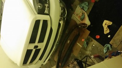

Just for grins and anyone else wondering about paint removal it can be done. Stripped it back down to the chrome.

Plenty of people have done it
That doesn't mean it was done right. In order to do it right, all of the chrome needs to be sandblasted off and the proper prep done if you expect it to last any length of time.

Agreed which is why I have all the correct stuff this time around. Lesson has been learned.

I know you can do it but did you sand down the chrome and use etching primer? You really need to use something like 60 or 80 grit paper and then when it is totally sanded to a very rough finish, work your way up with finer sand paper to maybe 220 grit. The etching primer is a main key to doing this and it hold up.
