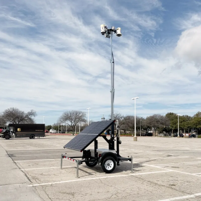

I’ve told this story before: Parked in a grocery store lot a couple of spaces away from a portable CCTV tower. Came out 15-20 minutes later and the FOB was unusable. It reacted exactly as you described yours acting. There were also a Honda and 2 GM vehicles there with their owners experiencing the same problem. After +/- 15 minutes all the vehicles started and acted normally. We all figured the CCTV tower was uploading data and interfering with the FOBs. Can’t say for certain that was the issue but, I’ve purposefully avoided portable CCTV towers since and have never had it happen again. That happened 3 years ago now.

police surveillance trailers at 7/11 & other chain stores, all over California
This one still has the wheels on it, which is unusual
I wonder how often they Download & Upload
The portability of WCCTV units means you're not stuck with cameras in one place, and you can dynamically react to changing surveillance requirements.
