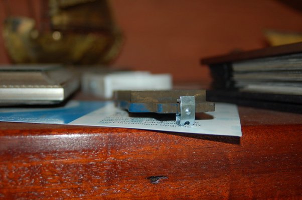

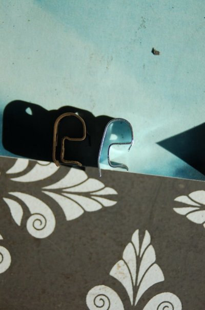

Small issue, but can create a problem. The clips that come with OEX will dig into rotors when the pad wears down, at least the factory clips on my wife's car wouldn't. You need to either use tin snips on the clip, or re-use factory ones. But, these OEX fixed a brake squeak and a grinding issue I was having in reverse. Brake pads are fantastic, but you need to work on these clips or way early you will get rotor damage. Those parts of the clips are on the same side as the brake pad, if you leave them like that I imagine when there still is about 15k miles worth of pads left they will dig into rotors.

This wouldn't happen until you were like 75% into pad life, then that clip would hit rotor, squeak like hell. You can see I had a decent amount of pad life left in her car, but it was squeaking like hell. I put the OEX clip on the old pad so you can see what I'm saying. Easy fix, and no reason to not buy OEX, in fact I love these pads so far and h395 has been using them for 20k miles w/o issue and he puts a good load on time to time towing up and down the Ikeman. Well, at least once.

Good find Burla! So would you cut that clip flush with the pad surface on install or cut way shorter?

I guess it depends, it acts as an early warning system for when your brakes get low. So if you are the type of guy who throws new rotors at every brake job, maybe leave it alone, when it starts scraping, you will know it is time for a brake job. But if you are like me and try and get at least one straight pad swap before doing an entire brake job, yeah take tin snips and just cut it off, or use stock ones.
Certainly a small issue, I like what these pads have done already.
