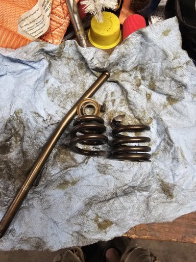

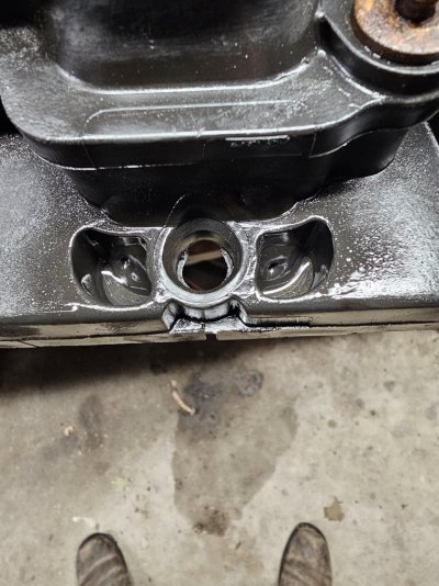

220k on my half ton and she shat a valve spring conveniently enough while I was having a poo in the house.
The victims: valve spring, intake valve and guide, a push rod and valve cover. I consider myself extremely lucky, the piston got a couple pecks on the face but is not deformed and can be saved from the multiple "experts" I have consulted with.
I'm hunting for a set of valve springs, a new valve, cover and guide as well as a set of push rods, head, intake,exhaust and valve cover gaskets. I was able to retrieve the two spring halves, retainer and both locks and there was no shrapnel to circulate through the oil system.
I need some help sourcing these parts and info. Done a little googling and I'm finding springs for "modified" cams, and all the related valve bits have specs that I don't have the instrumentation to get accurate measurements of the valve stems and guides at home. The engine is bone stock, original, and I intend to keep it that way. I am mechanically inclined so I will be doing as much of the work myself as possible.
If anyone has the technical information I'm looking for, please reply here or send me a DM. I did notice that all the new stock valve spring sets I have found utilize a 1mm seat vs the current 2mm, but I don't really trust the websites selling the parts. The sites I do trust don't have the parts listed which further concerns me and I would like to avoid the stealership markup if possible.

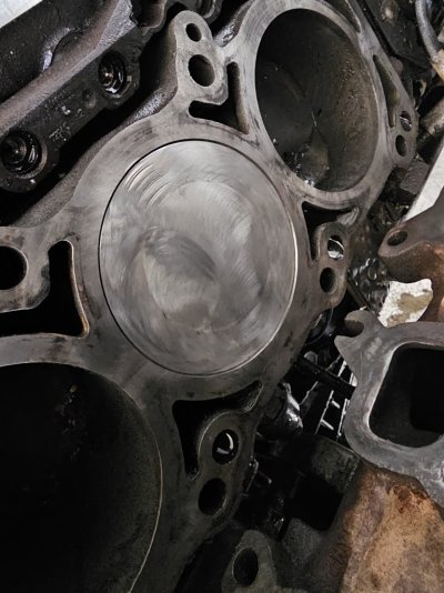

ah that piston would scare me to keep in. Any sharp edges like on that gouge are excellent areas for detonation to occur.
I was able to knock down the small ridges. The low spots are still there but it's very minor and smoothed out nicely. See below image

Is the cylinder wall scratched, indicating the piston ring could be damaged, I see a dimple on the block surface, indicating the valve edge did that damage, do you have a pic of the valve?

Other than a bent stem, the valve didn't even show witness marks indicating contact with anything. Even looking at it right now I see no indication of contact with anything so the hits were very light. I did check clearance around the piston with a feeler gauge and it's the same or greater than the rest of the cylinders on that bank which convinced me that the piston and it's bore are not deformed. I got it all back together today. Next post will have the update

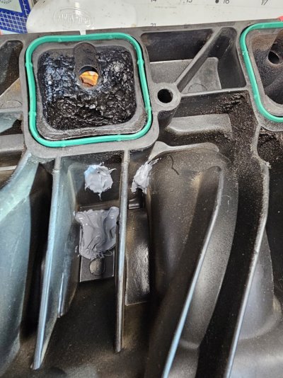

Diagnostics showed #7 fuel injector having no pulse. Noid light showed good signal, swapped #5&7 and the problem followed the injector so a brand used injector replaced it. Got all 8 injectors functioning but I still had lean codes and significant vacuum leak throwing codes and the truck was running like crap. I decided to pull the intake plenum to make sure none of the seals had rolled and discovered I had way more problems than I thought.
The hung open intake valve resulted in fire shooting back up through the intake runner, melting 5 holes in the plenum! I guess that would cause a significant vacuum leak. I went the sloppy route and packed all the breaches with grey rtv. Gonna let it harden for a day or two and I hope that'll get me by until I can source a brand used plenum to replace my ***** one. 1000002682.jpg1000002687.jpg1000002688.jpg1000002689.jpg
