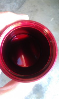

You will be surprised when you check it. I was. Mine has a couple ounces in it after only a week, about 250 miles. Guess it's working. :gr_grin:
