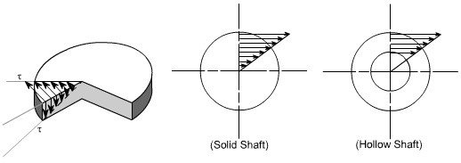

This isn’t what I’ve found on other occasions but it prove they do have solid rear drive shafts though. You are right about the weight reduction I’m not debating that, all I was trying to say this whole thread is that solid rear drive shafts do exist that’s all.
  • In comparison to a solid shaft, a hollow shaft is of less weight, for a given length and diameter. This is pretty obvious and wont be requiring any further explanation. Moreover it’s a good idea to go ahead with hollow shafts, if we our emphasis is on weight reduction and cost-cutting.
  • Hollow shafts are much better to take torsional loads compared to solid shafts. As shown in the figure, shear stress in a “shaft subjected to torsion” varies linearly from zero at the center to the maximum at the boundary. Inside a solid shaft, most of the material experiences / carries a shear stress whose value is much below the maximum shear stress [Interior portion of the shaft]. But at the same they are adding to the weight, without contributing much to the capability of the shaft to carry torsional load.

Still haven't shown any of us a solid core drive shaft for a vehicle .
The explanation you copied, does nothing but back up the reasons as to why they dont use solid drive shafts. It also does not say anything about them being used in a vehicle.
