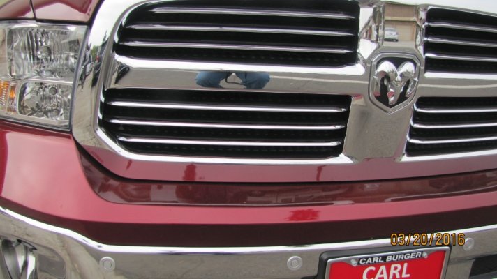

2013 & newer Sport front bumper uses the same grill & fenders as the chrome bumper does
2009 - 2012 front is different shaped
2009 front sport bumper - look at the bottom of the grille in the corners & the top of the grille emblem, they are more or less squared off
look at the same places on a 2016 bumper, those corners are cut off
