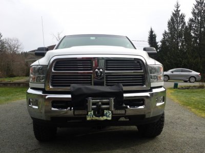

not inside.i mounted mine to a receiver that bolts to the towhooks.easier and cheaper,and i can mount it to the rear receiver by unplugging and moving to the rear,which i've had to do a couple times already.or i can leave it in the garage if i'm not off roading.

^ That guy's winch is going to rip off his bumper.

umm,how exactly??it's attached to the frame *******.
Not if it's attached to the tow hook mounts. The tow hooks are attached to a cross member that is easily bent (along with the bumper). You'll taco your bumper if you pull anywhere close to the winch rating unless you bought a small winch. The PW winch mounts to the frame horns and will hold double the truck's weight.

The OE tow hooks are rated for 5500 pounds OR 1.5 times the trucks GVW.

According to that break down the tow hooks don't bolt directly to the frame. For a bike rack or other relatively low weight applications the front receiver is fine. 5500lb is well below gvw and the receiver has a max tow rating of 9000lb. A winch exceeds both.
