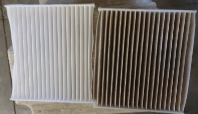

Notice in the photo above the left and right sides of the filters have no edge reinforcement or frame. The new one is concave and air will bypass on the edges. Every one I’ve seen is the same.
yes and that is OEM. really flimsy. but I guess it still catches a lot.

You can stretch the CAF some what back to shape. Just push 1 section at a time . All depends on the CAF. Works for me but even if it has the divot it will catch more then it miss's

brand new truck (2020 PW) changed at under 5000 miles give or take.View attachment 234171
I'm doubting a thing but just asking what should be asked, were you driving through dry/dusty areas or on dirt roads? It does seem abnormally dirty for any air filter over 5k miles.
a little bit. I had done the White Rim Trail but over half way through not a lot of dust on the truck. The engine air filter was clean as new still.
