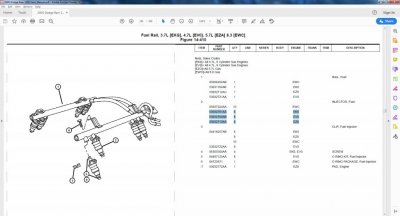

    Injectors are same ion 4.7 and 5.7.
    Hellcat lifters have bigger diameter rollars and are not same as 5.7 lifters
    Sent from my S60 using Tapatalk

    Ion lol? And they are? Perhaps you could explain this discrepancy? Sure look like very different numbers...
