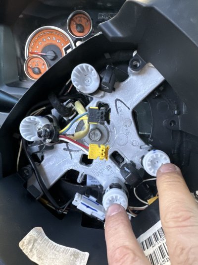

Anyone know if the horn buttons can be removed and replaced? I have custom leather on this wheel and don’t want to replace the entire thing.image.jpg

Also, the horn goes off for one minute straight. I unplug the menu buttons on the left of the wheel and it doesn’t happen and the horn works as it should. I broke a wire and that is why I want to replace. Otherwise, out comes the soldering iron.
I did the same thing, the wire wasn't broke but it was shorted. I fixed it with liquid electrical tape.
Why do you want to replace the buttons again? I'm not following?

No, the white buttons that actuate the horn.
Got it, It's been awhile since I've had a steering wheel open but is it possible to remove the whole assembly from another wheel (I think it is)? Otherwise, the horn will still work, it will just be dead in one corner.
