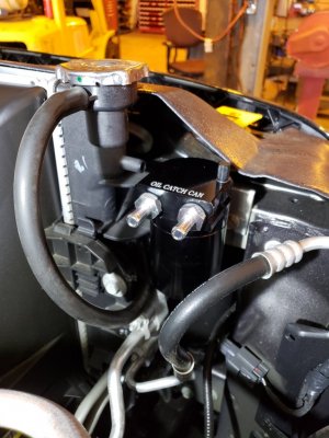

You all are right! My S&B intake left NO room on the other side where ideally one would install the catch can. That being said the alternative was where I installed and to others point when you unscrew the dipstick, I am getting some powerful suction so I know all is working. I am almost at 500 miles and will be unscrewing the can to see what is in there if anything.

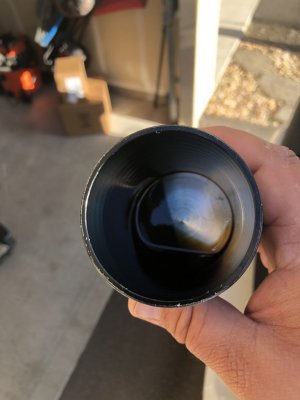

Hello all,
I have put 500 miles on and the picture was the result of oil. Not too much but still caught some!

You have a long hose run. Probably had to coat the hose a bit before enough stuff would stay entrained in the vapor to make it to your can.

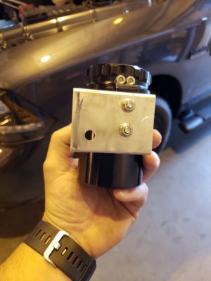

Just installed the Ruien can I got from Amazon. Used 1/4" by 2" aluminum stock. Cut a piece 2 1/2". Used 3/8 fuel hose and inserted into the factory rubber boots. Its a little bit of a PIA to unscrew with fat hands, i sacrificed ease for what i thought looked like a better spot.20180901_133830.jpg 20180901_133830.jpg 20180901_133830.jpg
