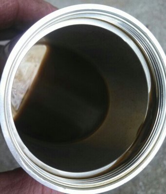

Odd thing. On both cars, when I installed the CC, a few tablespoons of oil were captured in short order. What was strange was, it never captured any more, nor any less. In other words, if left alone, it never filled up the Catch Can.
I used to empty it religiously every time I detailed under the hood, which was frequently. I would empty it out, and it would fill right back up to the same spot. I never found it empty, I never found it with any more than it's "normal" level.

FYI, as a super cheap and semi-good looking option, I just plumbed a fluid catch unit that is used on large air compressors and the like. With fittings to fit the DIA of the PCV hose , it slid right on and could be located anywhere mid-stream, so to speak. It was nice as I found gloss black ones, as well as the Caterpillar Yellow if you wanted something different. Nice thing, it has a clear plastic screw on "Vial" that serves as the Catch, and can be unscrewed to clean it quite easily, and being clear, you can visually check the fluid level inside in a heart beat without even touching it. With screw in hose fittings, you can get them at any hardware store for like $25.
