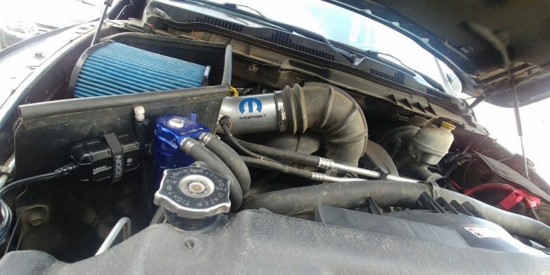

I mounted a CC on my 97 5.9 about a year ago. Mounted it on the inner fender in the engine bay. I get about a tablespoon of oil about every 500 miles in the can. one big benefit is it helps keep the intake and throttle body cleaner since the oil mist never enters the intake.
@Bill Blackmon for our port-injected Ram 1500s, I think this is the main reason to install a catch can. I don't doubt that the Hemi running at operating temperatures can burn that stuff up, and I think the gasoline spray would keep everything downstream clean enough. It's everything upstream of the injectors and downstream of the PCV inlet that I'm worried about. Even then, I bet it isn't terrible, but for OCD folks (me), or those seeking maximal engine life/efficiency (also me), I can see it being beneficial. I'm probably going to get one soon.
