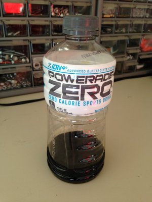

After a drive to the Smokey Mountains and back.
Reactions: SyN
Doesnt matter. If you read the post a few posts up from yours, he clearly explains that the small amount of oil that flows through your intake is nothing in retrospect.
Everyone has their theories and ideas. I dont believe it helps performance but I firmly believe that it keeps the interior of the engine cleaner and I dont think anyone can refute that. Move along, get over it. It does its job. Whether its worth $100 to you or not, well thats your choice.

Just emptied mine for the 2nd time since I installed it. This is how much has been collected total in 3k miles.
