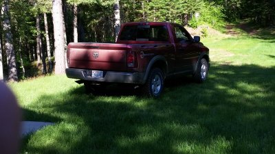

Not an option for me, outdoorsman come with a single side exit pipe so when I had my exhaust done it went to a shop and everything from in front of the muffler back was lopped off and replaced with dual 45's

Not a real good picture but you get the point. I'd have the new exhaust exit the exact same way.
