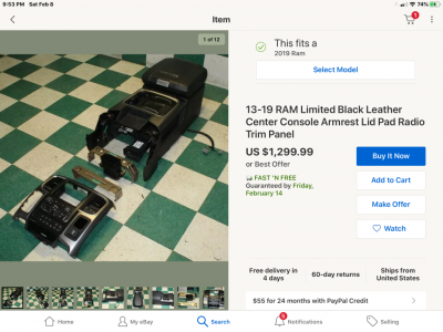

Kensil RAM
Jan 28, 2020
Midwest, IL
Cummins 6.7L
This is what you will need. The brackets and radio bezel are diff for floor console
