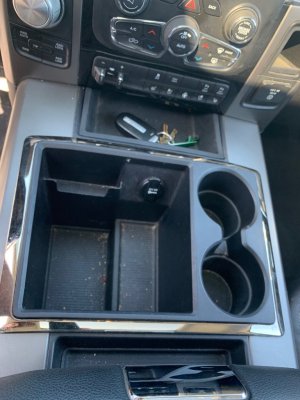

Have a 2014 ram 1500 with leather interior. And I have this center console. I want to swap it to this other console, and get rid of the card holder for a phone holder. Anyone know a part #? Simple swap?

Just look on ebay. You just have to replace the front Top section and the mat under the dash is different.

You can just purchase the black insert that you want and swap them out instead of trying to buy a whole new console.

After looking at your insert and then the one that's in my truck you may not be able to. I just noticed that mine has the curved edges where yours are more squared. I don't know without doing some research if the whole top piece is replaceable or not.

It is, you just have to replace the silver surround and the small rubber mat under the Radio bezel.

Yup. It’s 4 parts. The actual cup holder section, then the chrome trim that surrounds it, then the 2 silver pieces running up the console to the dash, and the rubber mat under the radio bezel. All you need is those 4 parts.

You can’t just swap the black sections, the two mid portions are not alike. You would these pieces to do the swap. image.jpg Sorry I don’t have the part # but I bet if you reach out to Benny(I think) over at all mopar parts(forum vender) he’ll be more than helpful.
