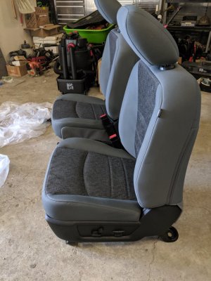

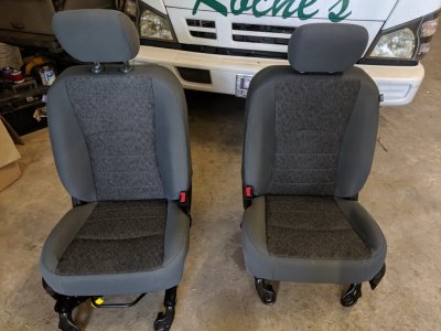

I have a set of big Horn door panels for sale of you are interested, as well as front and rear seats. Front seats are heated

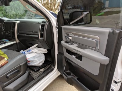

I had a picture of one door panel. I will take some later, just posting this so you can see what they look like
