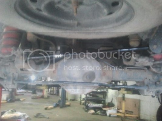

The suspension is not typical, I'm dropping a 4wd, which many people hate or are confused by, but I live in Alberta and deal with our winter conditions. This is my DD and drag truck, so having traction in winter and at the track is the only reason it's a 4wd. It has:
4/6 drop with GF front springs and McG's delux spindle kit,
Spohn adjustable control arms and panhard bar,
Michigan Metal Werks front upper control arms with uni-ball joints,
Kore high Angle CV shafts,
Belltech rear 2wd shocks,
Rear notch,
Hellwig anti-swap bar,

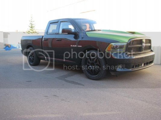

The exterior appearance mods are ongoing but the end result will be:
Street Scenes roll pan,
Stock hitch and spare tire delete,
Custom hidden hitch,
Shaved tailgate, fuel door, stake pockets, and antennae,
*******'s Speedstur fiberglass tonneau,
APM hood,
Custom built deep mouth front grille,
Custom lower air dam grille (possibly with tow hooks for the track),
2 tone paint - snakeskin green, brilliant black - hopefully in spring funds permitting,
22" 2Crave No. 8 wheels with 305/40R22 Nitto NT420S rubber (should completely fill the wheel well)

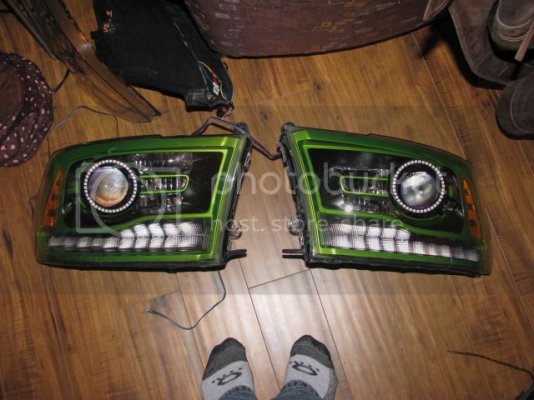

Custom painted '13 projector swap (did this before the RS harness was available),
Projector fog lamp swap using Morimoto M1s - painted,
AAC RGB LED halos in heads and fogs,

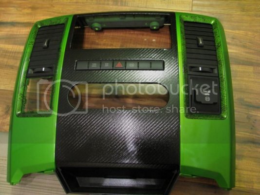

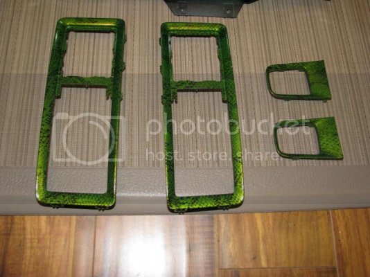

Painted, hydrodipped, and Di-Noc carbon fiber panels,
