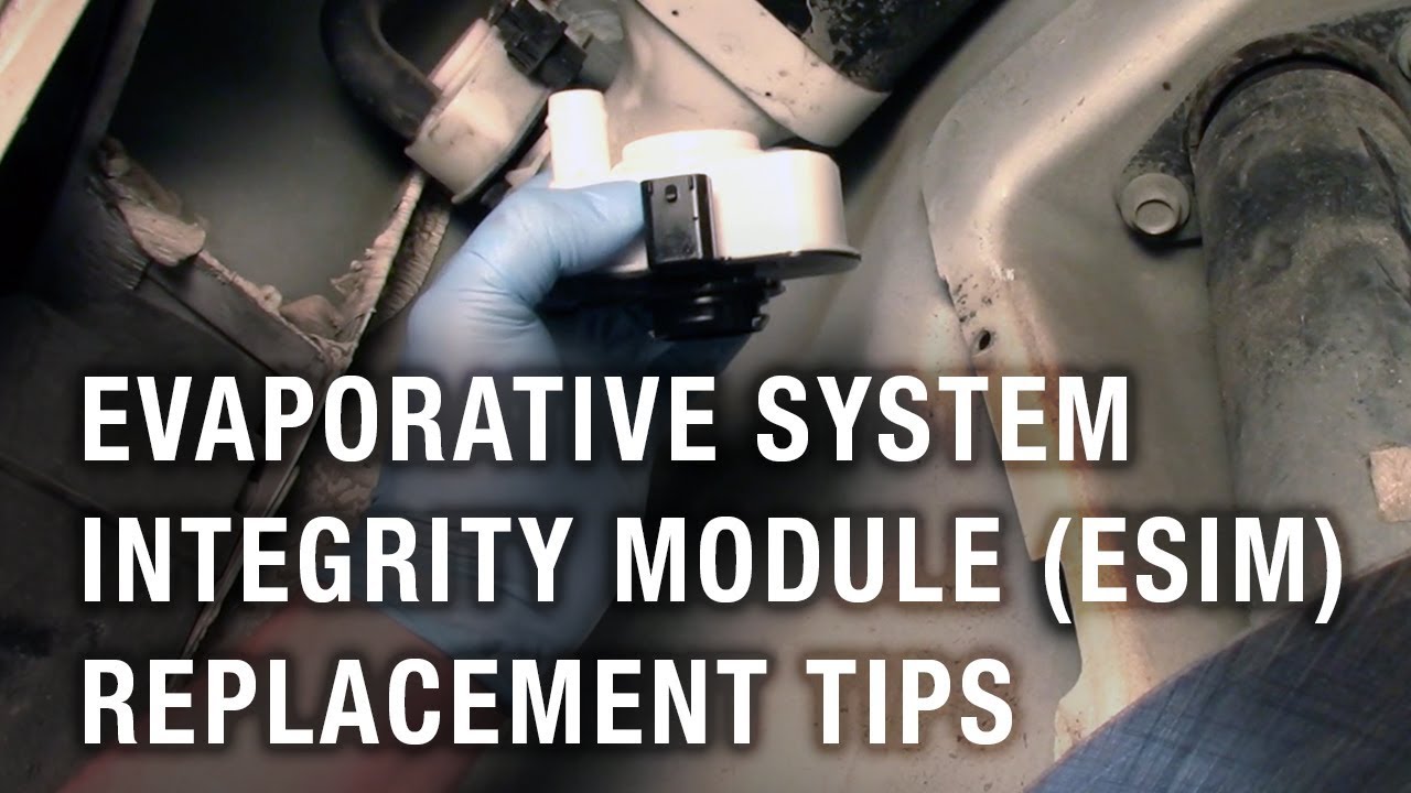

that code could mean
Bad Purge Valve, can be checked with a Mighty Vac tool, some ppl have use their lips to do the test
Bad ESIM
Gas cap would be the last thing to check
very good DIY video
