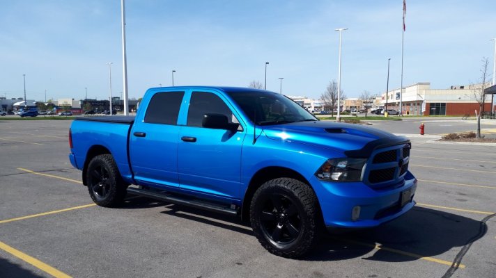

Well worth it!
My baby was done right after I bought it, and every year since in the late sprig/early summer. Then I seal and shine her up.
