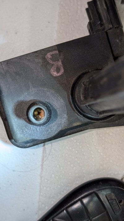

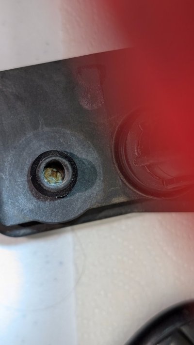

The 3rd pic shows the screw head in the coil towers you want to try and get as clean as possible.I've never been able to remove them,so you're stuck cleaning them in place
i use the red handled pic to scratch as much corrossion out of the tower as i can ,before i use the little Dremel carbon steel brushes to polish it up as much as i can.If you don't have a Dremel,a 3/8" drill either corded or cordless works just as well as a Dremel
