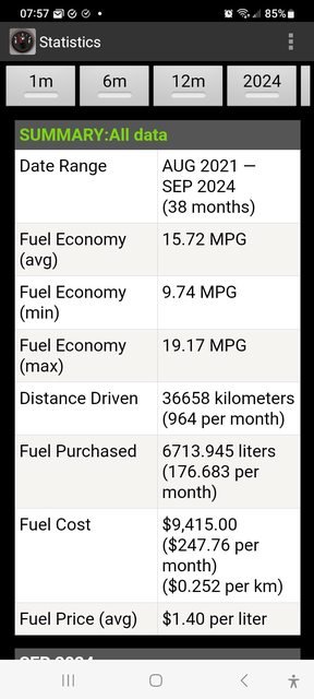

Save your money, no Cold Air intake is going to pay for itself in the gas you could save over the whole life of the Pickup. You can improve the mileage on a pickup that is highway driven. If it is used mostly in stop and go, nothing you do will help except being VERY gentle of the Go and Stop Pedals.
So for comparison, my wife's 2020 Grand Cherokee with the 5.7 will do between 28 and 33 MPG over a full tank, hand calculated on the highway. Around town, it averages about 19-20. Stop and go reduces it by over a third. Your pickup is not going to do as well due to weight and aerodynamics.
My 2500 with the 6.4 will do as high as 19 on the highway, around town, 12-14 mpg, so a similar 1/3 penalty. Neither gets driven gently so could probably improve the around town, but I really don't care.

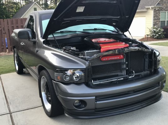

Hemi 5.7, supercharged
Op, besides the vararam, this is a great cold air intake. It's extremely expensive but I buy them used for cheap as most people try to sell them when getting rid of their truck.
Ma Mopar approved

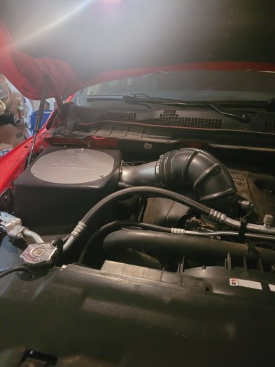

I went with S&B for mine. However, I also put on a ported throttle body, long tube headers, better flowing cats and a good cat back. Tune will come after I can get an upgraded cam.
