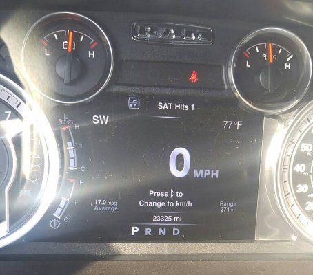

Just unplugged my compass module. Cycled the key, and the compass heading is displaying almost immediately.
Off to work, I will see how reliable it is over the next few days.
Edit: (Stayed on the entire drive)

This morning after work...
- No compass heading again (so still flakey).
- Stopped for a biscuit and power cycled the key while waiting in the parking lot ...
Compass heading came right up immediately.
@RLk, when it works, it does display in the cluster as well as both spots on the RA4, when it doesn't work, just 2 dashes at all 3 spots.
So yeah, send the compass module, it's worth a shot.

I had my battery disconnected while I swapped out my steering wheel and clockspring earlier. When I started the truck after reconnecting the battery, I had no heading. I shut it off and when I started it again about 10 minutes later, it was working again. So weird.
This is exactly what I am noticing on my truck with the compass module disconnected. Doesn't work after starting up/driving around. Power Cycle the key and it comes up, next drive it's off again.
Still Works more often than with the module plugged in.
Just a small update ...
power cycling the ignition when the heading info is missing consistently brings back the heading/compass direction (w/o compass module connected).
Note sure what I will do if I ever get a HomeLink/compass module that needs to stay plugged in.
Edit: May not do it ... Homelink not working in heat
