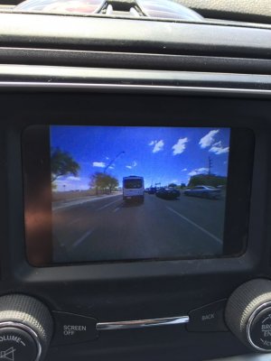

Can’t answer specifically to the 8.4 but I just had front and rear installed on my ra2 and had to get some sort of interface.... I didn’t do it I’m no good with this kinda stuff lol. But will say the front camera is AMAZING I took my tuck out yesterday and is awesome to see in front of the truck when I can’t from driver seat.
Can you access the cameras independently? Is there a button added when you introduce a second camera?
Yes & yes. I can turn on either front or rear. When switch is “off” when in reverse rear comes on and when going under 10mph front comes on. That’s my switch. You can hide the switch if you want but that spot works well for me
