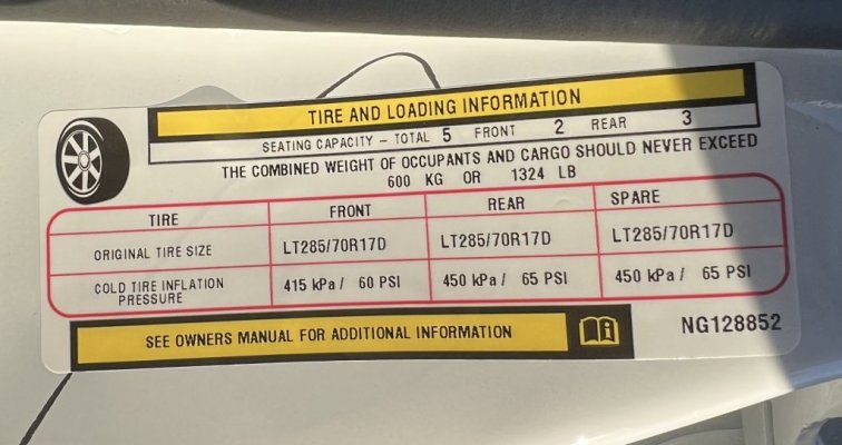

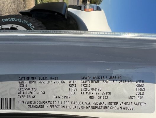

AGAIN what does your door sticker say? my 2020 build says 6000 my door sticker says 4750 and I bet yours does too.

The door stickers takes into account the springs. The build sheet takes into account just the physical part. Power wagons have soft springs there for have a lesser rating. A diesel has stiff springs to have a higher rating.
As the truck rolls down the assembly line, what part to they pull off the shelf for the front axle? The build sheet say the power wagon, 3500 and 2500 all get the 6000# axle housing. I work in a factory but I can't be the only one that understands this.

I totally understand the 6000 housing is the same, if you look at a post I made at the beginning I said they have the same front axle.... post #4, the set up is different however and more than just the springs. I asked the owner of AEV if he would consider making a set of HD coils for a power wagon and he told me no and that the articulink is something that causes the vehicle to list when too much weight is added.

I have a go fast camper (these are light under 500lbs) and with just me and my wife so 350lbs between us I am at 4620lbs on the front axle. put a heavier camper and more gear up front I would be heavier. I think until people actually weigh their trucks they have no idea how close they are to maxing out their front axles.

Interesting, that makes me think the front axle rating is just barely enough for the truck by it's with anyone in it. Most of the camper weight should be on the rear axle. The front added weight would be mainly the passengers.
On a side note, you're truck has nearly perfect 50/50 weight distribution just like a sports car.
