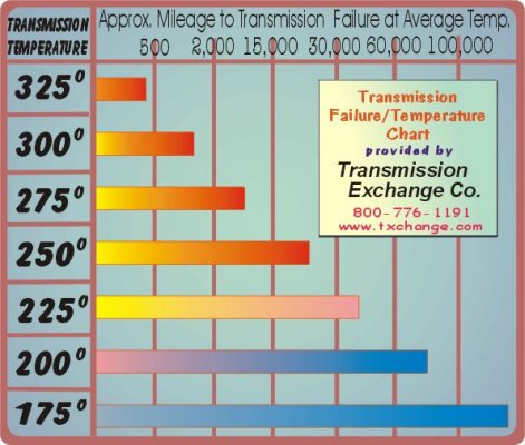

Transmission shouldn't get over 200 degrees Fahrenheit during daily driving. Towing the tranny temp might get up to 220 or so but if the temp got anything higher than 250 then I would stop and let the truck cool down. Here is a cool chart that shows the hotter temps you run the shorter life your transmission will have.
