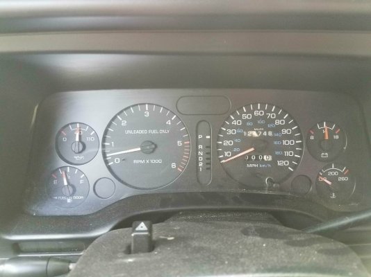

Does it matter that i have an analogue odometer?
d14396570125e25cd0df621b548db2dc.jpg this is what i have for a cluster
You know i'm not sure. You can give it a shot.

Yeah it didnt do anything. Im in the process of taking my dash apart as i type lol

Yeah, I thought that the cluster self-test would be a good check but then I realized that you have the old-style cluster. The self-test module wasn't introduced until 1998 with the new-style clusters.
