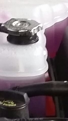

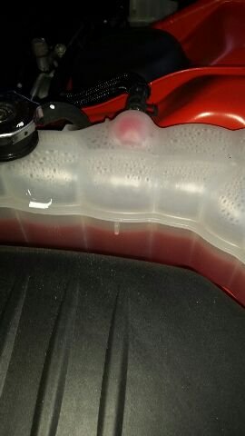

☆☆☆☆Important note☆☆☆
I have not done any coolant system work to my wife's 2016 Challenger RT Plus with the 5.7L
This is a photo @ just uder 900 total miles as I was installing her BT OCC. Notice the absolutely PURPLE coolant reservoir .

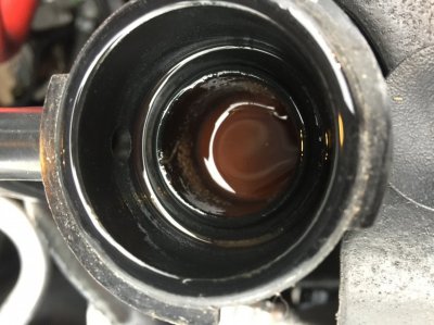

Today @ 4,356 miles , cold has not been driven in a week and it's 38°f outside . This is the same system coolant & is absolutely the same Orange tint as my truck with 44k
My Truck 2014 Ram today @ approx 44k
Cold engine as well.
So , this is plenty proof to me that the Purple OAT coolant does in fact turn Orange with time & heat .

Her car is straightfactory Chrysler Purple OAT , my truck I'm running my second application of RMI-25 , but I've never done any coolant work .
I do remember the first RMI-25 I put in my truck , my coolant wasn't this dark orange , in fact it was pink to the naked eye in the Radiator.
I guess this purple OAT does turn Orange and gets darker orange with time ...
