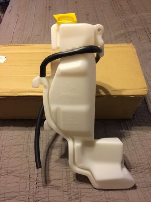

This rascal was just delivered! Outstanding quality and fit/finish is perfect!
It will be nice to be able to observe the condition/level of my coolant without have to mess with frogging dipstick. I will install it tomorrow!
One thing I noticed was there was no level marks. I guess I will make my own about what I figure is half full.

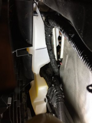

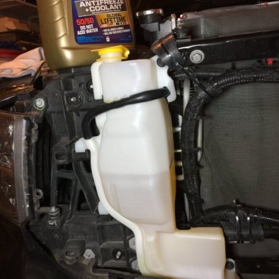

OK did the install this morning.
install went very smooth and fast.
The only modification I had to do was to trim the two support clips that slide into the slots that's in the front of the truck.
Actually I just got my pocket knife and made the slots a little bigger so the two clips can slide into down into them. If that makes any sense?
Anyhow I do believe this is a very beneficial modification because now all I have to do is pop my hood and look down through the big hole where the hood latch is and I can visually see the level in my coolant tank now.
If it is dark outside you might have to have a flashlight to shine down at the tank itself.
Here are a few pics after the install.
The first pic is looking down through the somewhat large hole where the hood latches looking back at the tank.
I am very satisfied with my $32 investment. I filled the tank close to halfway with a 60\40 mix of PGL.
Next will be the Tefba inline coolant filter install.
