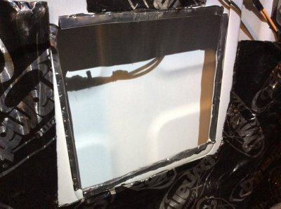

Since you're going to have the door panels off add some sound deadening to the door skin.

I used stinger roadkill extreme, dynamat works good too. Depending on how much of the panel you want to deaden you can add it through the speaker opening and reach in as far as you can or do like I did and remove the inner door card and do the whole door skin.

That's a good idea, did not put any on mine when I did it
Quick Google , wow that stuff is expensive .....

It is well worth it. You will notice a difference. Most of your local stereo shops should carry it.

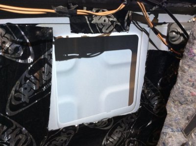

once you remove your back seat, there is another problem area for rattles back there. The cabin pressure vents rattled like crazy with low bass notes. it wasn't the rubber vent that was the issue but the loose fitment of the vent itself. Since the seat will be out might as well do that too. Here was my solution for it
