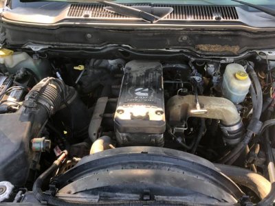

Hello Friends, My 2005 - 2500 - 4x4 Cummins Diesel With a Automatic Transmission --- It Runs Perfect. But when you let up on the accelerator, It keeps going at the same RPM for a Quite a few seconds, And when you have it in neutral or park and rev it up to any given RPM, Then let up on the accelerator, It will hold that RPM for Quite A While, Then (Very Slowly) come back down to a idle. I am wondering, Is that a Bad Throttle position Sensor or what ? It had a New and injection pump less than 8,000 miles ago. New / Rebuilt Injectors, New Fuel tubes and Fuel Lines less than 20,000 miles ago.Thank You All.

I'd be a little suspect of the rebuilt injectors. Sounds like they are not closing. Rebuilts don't always have the best reputation. Are you getting any white smoke when you start it cold in the morning?

I think your problem is a faulty accelerator position sensor. I have never changed one, but I have read about the same scenario you have posted and this was the fix.

When you rev up a common rail you are spiking the rail pressure and that pressure has to go thru the injectors to bleed off. Slow rpm drop is normal. however get a video so we can see better on whats going on.

Thank you very much, I am starting to hear that a lot. Also Maybe it's because I am just not used to it ? I have never had a truck this new, 2005, I am used to First Gen. Dodge Cumminns Trucks, With the mechanical pump, You Rev it and it falls back to idle immediately.

On a 5.9 Common Rail setup, the issue you are describing is from the injectors. Rebuilt injectors can cause slot of problems if they are not done correctly. The seals in the injector are likely bleeding off fuel pressure once the injector has closed and that is what is keeping the RPM up and coming down slow and it probably stutters while coming down.
Think of it as a needle and seat and the seat leaking fuel into the carb causing a rich condition.
