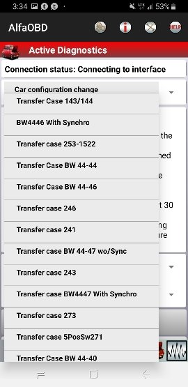

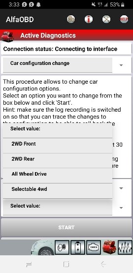

Curiousity question for the AlphaOBD guru's.

It looks like you can use it to change transfer cases,so I was wondering if it's also possible to change the 8 sp transmission variety to.Kind of curious if you could swap an 8HP90 in place of the 8HP70 or an 8HP95 Trackhawks tranny and AWD transfer case,and use AlphaOBD to change the transmission/transfer case type.Just a curiousity question,lol

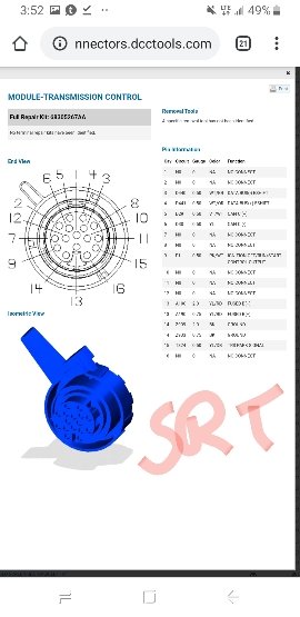

So the tranny plugs are the same. I attached three. One our trucks, second is the jeep and third is the challanger.
It actually does look very doable. e3810e7506a573d14b6ea5d4c603c7a4.jpg4fc1298eec40c874dcabd87f0c052175.jpg47f29ba6417861c9e3e19d9bf850a62f.jpg
