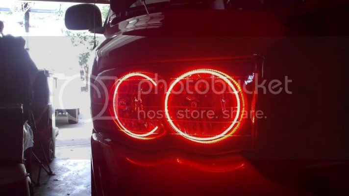

do any of you guys have halo headlights and fog lights?

Pictures do them no justice. I got them from retroshop.us Jeremy is a vendor on here. His customer service and products are top notch.
