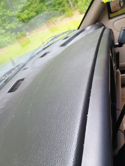

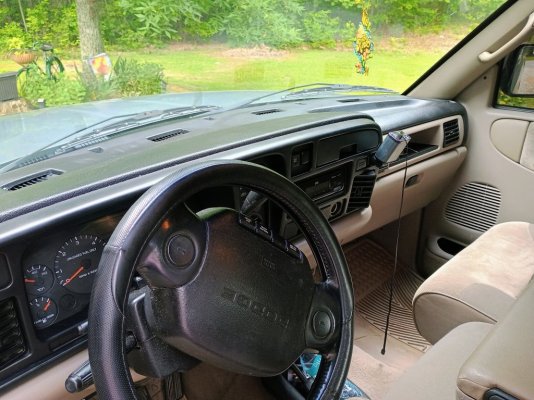

My son has a 1996 Dodge Ram 2500 and his dash was broken/ cracked very badly as well. However, he found a company called Dashskin online and ordered a new cover cap for his. It worked perfectly and was so easy, that he was able to install by himself with the provided silicon adhesive. ( He is only 16) He installed about a year ago and its still looking great and has remained in place with no issues.
