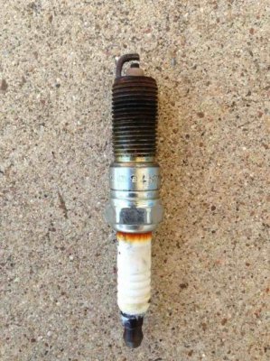

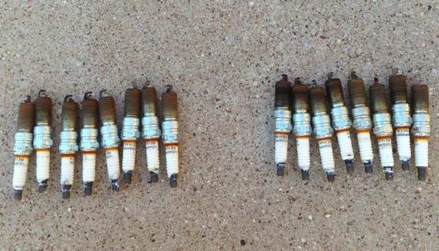

Original spark plugs at 71k.
I originally said I was going to do this on the 4th of July but got delayed.
All 16 were champion plugs OEM from factory. Swapped them with NGK 5306 V-power copper core

I see a bunch of broken insulators....So what does the butt dyno say after the new plugs? :secret:

Well i just got done 30 mins ago took a stroll down the high. Couple cars were trying to keep up. Granted they were 4 banger tuner Hondas. I am happy now for the transmission and o2 sensor and fuel pump eventually
