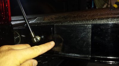

Well, that went wicked easy. I didn’t have any problems with the nutsert. I took the advice and put a little of the thread lock underneath where it meets up against the tailgate. I’m not sure if that made a difference or not, but it didn’t hurt.
I wanted to share what precautions I took based on the warnings I read in the forums. Also, see the pictures below…
Underneath the Deezee drop adapter I put some 3M clear body armor film there to help reduce the metal adapter rubbing the truck bed paint off. I also painted the drop adapter black with spray-in liner spray I had laying around. I didn’t like it silver among all the black.
I put more 3M clear body armor film on the Deezee assist strut and on the tailgate where the cable clip rubs. I figured over time, the rubbing would ruin the paint. Where I live, you wouldn’t want that…they don’t call it the Rust Belt for no reason.
Lastly, I put in a neoprene washer in place of the limiter you had to take off for the same reason as above (live in the Rust Belt). I put a tiny bit of thread lock on that bolt because I had to leave it a little loose so the cable will move freely.
I hope my ideas help someone else like you guys help me. Take care.
You are a genius...
I noticed mine has worn off some paint and wasn't sure what to do besides get it re painted.
I have a roll of that 3M stuff I use for various things. Just went in the garage and cut some of it up and applied it in those spots..
Still might need some new paint, but it will at least protect it for any more damage.
Thanks man!!!!
