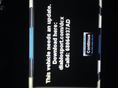

3 hours last night trying to download drivers and such, 2 more this morning and I still don't have it installed...
This thing is a freaking nightmare. It keeps telling me my vehicle needs
A download update.
This diablo is a PITA to install!!!

Errors
After errors...

I meant did you get everything on the computer set up correctly? OS/version of the computer?

If you setup the DSDownloader and the drivers installed correctly, plug the tool into the computer and it'll read the tool, you may need to register the tool on the diablosport website which you can find the ID in the tool itself. Then I believe once it reads the device you just click on express tune mode at the bottom and update the tool. But in order to get updates you need to register the device. It should update the tool from then on automatically, but you'll need to reset the device in order to update each time.

Ya I'm not even getting that far, I'm starting to think it's the fire wall on my computer and it's not letting Diablo get in where it needs to be.

BELOW ARE MY INSTRUCTIONS FROM SEAN @ HF:
NOTE : When tuning, leave the driver side door open so the key off steps completely turns off everything.
When you get the tuner, first thing is to plug it up to your pc and run an update using dsdownloader which you can get from the Diablo website. That's found in the downloads section on the Diablo site. Run dsdownloader with the trinity attached to ur pc. Then click on the express tab and then click on update tool. Then load a preloaded tune file in ur vehicle. If your pcm isn't at the latest flash revision it will state that and then you can go back to ur pc and run dsdownloader. Click on Calibration Update to download your new pcm info into the tuner. Once completed carry it back to the vehicle and it will flash the pcm with the latest revision. If you have any trouble with that, contact DiabloSport tech support and they can walk you through it. Once that is done, THEN you can load in a preloaded tune file.
Once you've loaded in the preloaded tune you've chosen you can then use the dsdownloader application again. Click on the express tab and Get tune from tuner to get the last tune written and original backup file. Email me both of those. I will edit the tune and email it back with logging instructions. Here is a video on how to do that : Trinity tuner last tune written and backup file download - YouTube
Here is the forum section for using a MAC : Diablosport Forums • View forum - Mac/Non Windows based issues

That helped a lot ^^^^ that's completey different than what I was doing and the video was spot on THANKS. !!!!!
