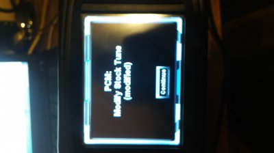

Ok so I got to playing around with the t1000 and I got the unmarried one in demo and the other in the when I choose a 2006 mustang gt. I'm guessing by what I have found this puppy is married to a mustang. What I don't get is why it says tool unmarried. I tried I update it and it wouldn't let me it said I need restore the back up to the vehicle I clicked the force update and it's asking me for a password and is giving me a key number sand saying contact support.

Last update called diablo and they were very helpful walked me through it. It was unmarried but I guess it had a backup file that wasent returned and needed to be rest and cleared out. The tech walked me through it and I am now in the process of updating it. Easy peasy I now have a diablo t1000 for $250 got a good deal!
