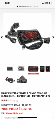

I’m planning on doing some performance upgrades to my truck in the near future and I want to start off with a CAI and then a tune soon after. When I look at the options for the trinity programmer from Diablo, there are two options available, unlocked pcm swap and modified pcm. I assume the modified pcm means it is preloaded with tons of custom tunes on it (correct me if I’m wrong) but is something like that really needed if you’re adding things like a CAI, exhaust and possibly long tube headers with high flow cats? I’m only asking because the modified pcm swap is $300 more than the simple unlocked PCM swap and if everything will run perfectly fine with the unlocked pcm option and still give me a noticeable gain in performance, I don’t see why that wouldn’t be a good option. I know literally nothing about tuning so any help would be most appreciated.

What year is your truck, someone will chime in but I think you only needed the PCM for the 16+ models.

Here are your options with the pcm
2014 and below you do not need a u locked pcm and only need the tuner but only some 8spds can be tuned.
2015+ have to have an unlocked PCM
2018+ have ti have an unlocked pcm aswell as a security bypass cable I believe.
Modify your pcm:
You can take out your pcm send it to diablo and with I believe a week they will have it back unlocked. Con though of course the truck won't start.
PCM swap (I did this option) :
You send them some numbers on the back of your pcm and they program a used pcm to your truck and when you receive it you swap it out with your stock pcm and send your pcm to them and you keep the one that was sent to you. Downside about this you have no backup pcm.
Modified PCM: they send you a unlocked pcm just like the swap except you get to keep your stock pcm. Downside expensive.
A good trick I've learned on here was people buying a used pcm on ebay and doing to pcm swap and sending that to diablo lol so you still have your stock one.
This is a bit of money but aswell the "canned tunes" (tunes that come preloaded into the tuner) are alright per say. Not bad. But a custom tune with a custom tuner is a even better option (I went with Greene Racing).

@Cwils80 nailed it with his explanation.
Regardless of which option you choose you still need a programmer that comes with the standard tunes package.
If you want the ability to add custom tunes to your truck at a later date get the Diablosport programmer of your choice that is labeled on their website with the red banding & "Custom Tuning".
I purchased an InTune I2 programmer and a custom tune package for my 2014 6.4L CC. The difference between the "canned tunes" that came with the programmer & the custom tune I added was definitely noticeable.
