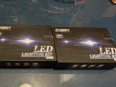

I used the Fahren brand for low and highs in my quad reflectors. When up against a garage door, I noticed the drivers side was down a bit which I understand why but it bugged me so I raised it to match the passenger side.
I still don’t get flashed by anyone so I’m happy.F7F79814-F4ED-467E-BE43-B2D0344C91BD.jpeg813B9794-0FFE-4616-AFE9-1CD2372DF54A.jpeg
