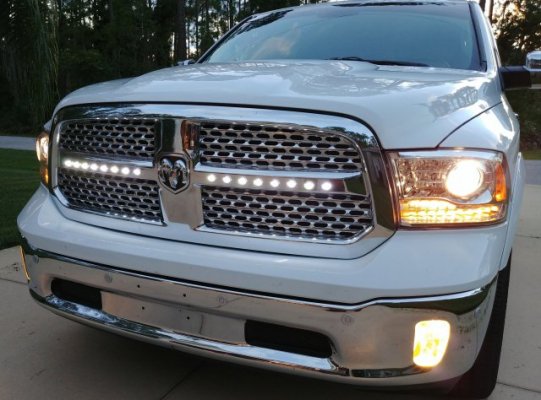

What leds? Project details?

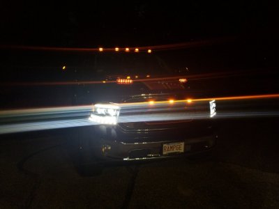

Very nice look, any night shots? Just curious how bright they actually look in the dark. :)

Where did you get the LEDs? I like that!

Thanks Kad. Wasn't trying to take credit for your write up just trying to show another option.
lol, didn't think you were. :) I just threw the link in for anyone who wanted it or the links to the parts.

I was going to put lights in my grill but I like the look too much and I replaced that grill and Pooh doggy wasn't cheap lol.

oznium.com has lots of LEDs of different shapes sizes and colors

Love it !!! Been looking for a hood for a while to do the same.

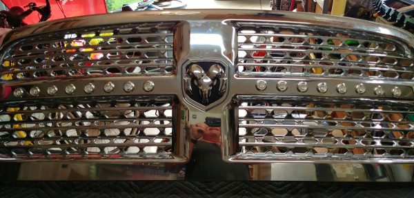

3/4" LED's, 100 lumens

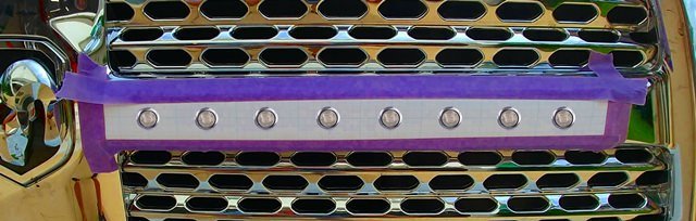

Basically I took the grille off, taped on a template, drilled 16 holes, wired them in sequence. Used slot # F66 in the fuse box so they're on w/ ignition.
How to did make this template?
