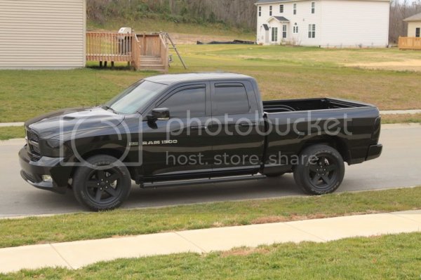

I decided to try Plasti Dip out on my wheels. After reviews and various write ups and youtube videos I figured it would be worth trying and if I didn’t like it, it can be easily removed without any effects to the wheels underneath it. I located spray cans of it at my local Menards for just under $6 per can. I picked up 3 cans and that was plenty for 4 coats on each wheel (NOTE: I did not put any on the inside of the wheel).

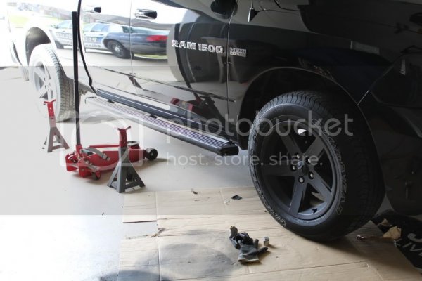

Park on a level piece of ground or in my case, my garage. Place the parking brake on. I started on the passenger side first. I used some blocks to chock the wheels for added safety. Start to un-loosen the lugs while the vehicle is still on the ground. You’ll need a 7/8” socket and the lug lock key if you’re wheels have them. Then once they are loosened, raise the vehicle and finish removing the lugs. Then take the tires off. I had to kick mine around a few places to loosen them from the light rust holding them. Once the tires are off, I made sure to keep them in order on the ground as they go on the truck so I didn’t forget which was front and which was rear. Then I put 2 jacks under the frame and let my Jack take a break. I then placed the tires on the ground and used a large piece of card board underneath them so to not paint the flooring.

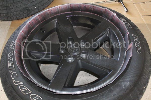

Then I placed cards from an old card deck I had around the wheel rim. I overlapped them about ½ inch. This trick works if you don’t have a lot of wind. A few times my cards blew off but didn’t affect the drying process.

Apply a light coat of Plasti Dip. First get the hard to reach places then the easier spots. I stayed moving around the wheel and kept the spray nozzle about 12” away from the surface at all times.
1st COAT:
Wait 15 MIN or more between coats. Don’t worry if the stuff looks clumpy, shiny, or un-even….the magic happens when it dries. If you applied it mostly evenly and 12” away from the surface, by the 3-4th coat, it’ll be evenly dried and dull in finish color. REMEMBER to be in a vented area. I kept my garage open with a box fan moving air out...this stuff stinks!

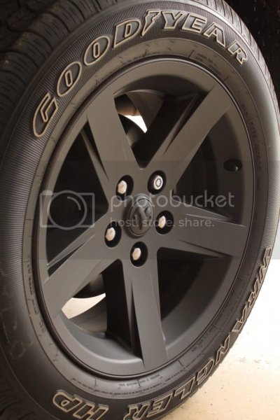

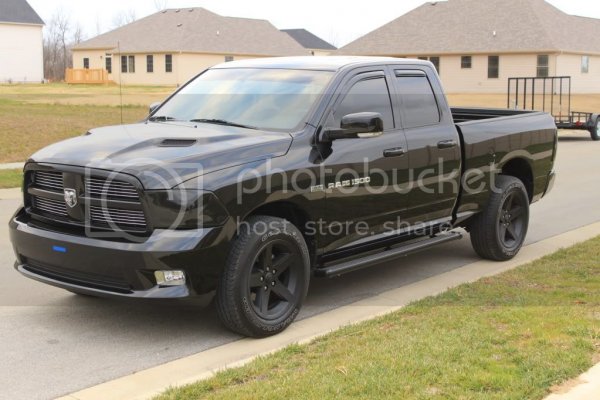

FINAL LOOK:

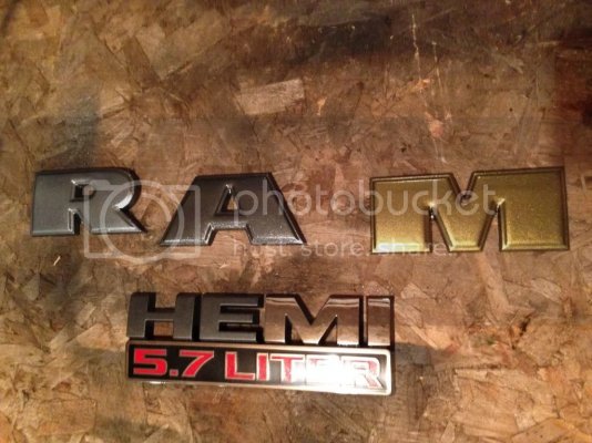

I will eventually black out my emblems and lettering. I will try to report any problems I encounter (if any) in the future with this on my wheels....right now I'm LOVIN' the look!I hope I have made this write-up easy to follow. If you have any questions just ask.
