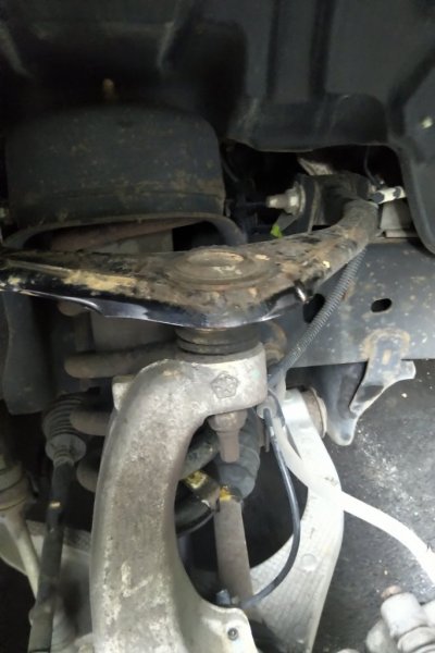

I've had these 305/50-20 tires on stock wheels for 2 or 3 years. I noticed the other day they have been rubbing the
end of the upper a-arm. Made a shallow groove, not to the cord. I think 1/4" spacer would take care. Would I need longer wheel studs for just 1/4"?

For a 1/4” spacer no. But find a spacer that’s hubcentric. The stock lugs are decently long off the bat so no worries there.

Did you check your truck's wheel bearings ...just in case?
Also, is there any unnecessary material on the end of the upper a-arm you can grind off (w/o affecting safety)? Doesn't sound like you'd need to remove much. And just rounding off the rub area might help too.

Asked for pics,,,,

Looks like a few whacks on the end of the UCA with a BFH would resolve the rubbing issue.

Why would you mess with the cost and problems of spacers when you could easily gain an extra 1/8" (or more) by 'tweaking' your UCA in about 15 min of efffort? There's barely any wheel rubbing now. Probably only during wheel flex at sharp corners.
How are you tweaking the control arm? Looking at it I don't see that I can. The clearance is supper close with the oem wheels and 305/50 Toyo AT3 s that I'm running.
