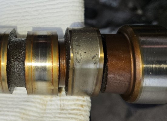

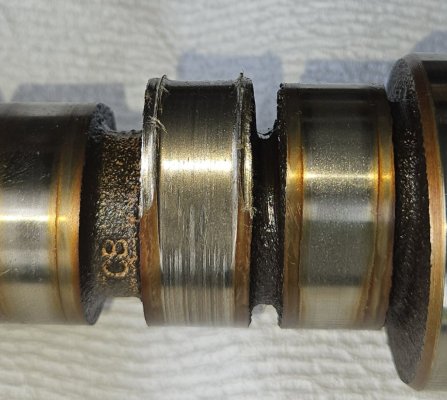

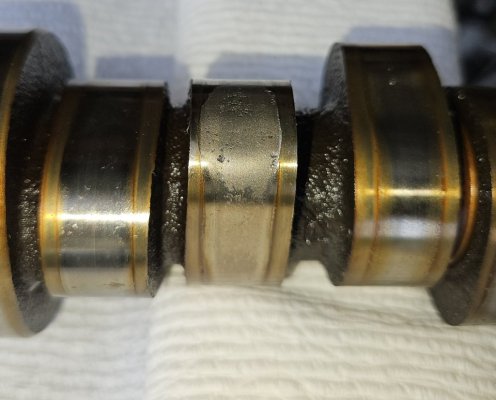

Is there any concern of metal pieces clogging the oil pickup tube screen?
Or are the shavings from a ground cam lobe fine enough to pass that screen?
Doing my cam/ lifter replacement this weekend. 2011 w/ 128k, I always limited my idle time for this very reason.

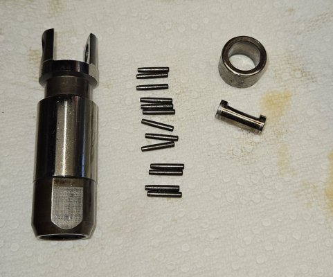

that's already been debunked as bullsh*t... the majority of people have not idled their cars during the life of the vehicle when they experience cam failure...
Fleet cars fail from lack of maintenance and people literally beating the sh*t out of them..
But most lifters fail from to hard of a hit of the lifter on the cam...(this is why 2003-2009 engines dont really have this issue, they dont have the higher vvt lift). MDS play into that alot... Non MDS engines do fail also but it can still be a piece of debris in the lifter oil galley... a manufacturing defect etc...
Engines that use roller lifters will normally always experience lifter roller failure before anything else goes... (GM Ford Aftermarket etc)... Roller lifters are inherently the weakest part of modern engines... but the efficiency is the trade off.
One thing i find interesting is the 2003-2009 engines also have "magnets" on the MDS solenoids to catch metal debris... I pulled a 2005 MDS solenoid out and it had a small sliver of metal on it like a fingernail... that size of an object trying to go through the lifter oil galley would have been bad.
