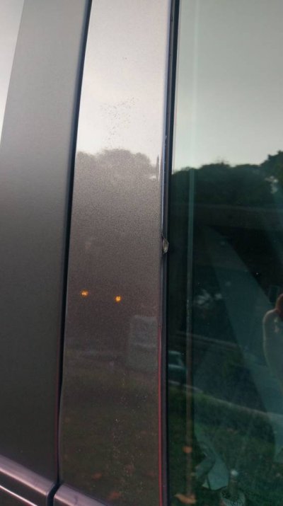

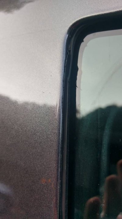

How do I remove the inside vinyl pieces? I've got tiny pieces that are tucked in on the inside of the window and I can't seem to get them out... 2245b9b46656b0fc6e561eb4ed4ee95f.jpg2e9c60822cef5ce19c9cee73b7c201b5.jpg

I was able to remove mine by rolling down the window and holding the rubber molding back.

Open the door and roll the window down- there is 1 screw on the back side that you can remove that will allow u to "peel" the vynal off-
Do a quick you tube search- tons of videos showing the screws-
I suggest you do it when it is warmest out as the vynal tends to peel easier- or get a hair dryer or a heat gun, I did mine when it was like 80 out and my truck was still new- Peeled right off. Try to peel it all in one piece - try not to tear or rip it.

Open the door and roll the window down- there is 1 screw on the back side that you can remove that will allow u to "peel" the vinyl off-
Open the window! That was the ticket...already had the heat gun going.
