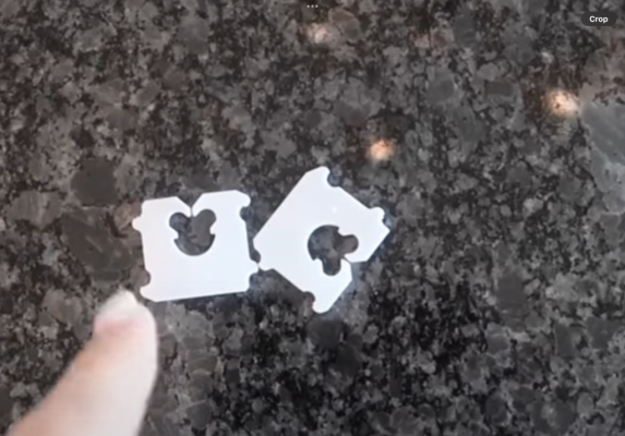

Those little square-shaped flat plastic closures found on some loaves of bread are what is said to be a virtually permanent fix.
My original fix that I posted here worked for a long time. Eventually the washer wore out earlier this year and the one I replaced it with didn't last as long for some reason. I had a plastic washer laying around that I cut a slit in and snapped around the post. Been a few months now and it's working good. Those bread bag clips would probably work great. Luckily all of the solutions here are inexpensive but I always misplace the extras I buy but I know I can get one of the clips from the kitchen any day I need it lol.
