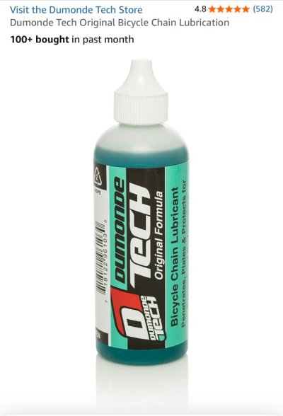

To go along with the washer issue... I used the O-Rings that were mentioned and they didn't stay on very long. Maybe a couple of weeks before I found one had come off. Now, I'm pretty sure all of them are off, and I just deal with the noise. I thought I'd try the washers, but sounds like they will work themselves off of the post as well. Maybe some of that chain lube will work. I might give that a try.

I tried the chain lube... worked for a couple of days and I'm back to the normal sounds. :(

What was the name of that chain lube, seemed like it lasted quite a while
it may have been PJ 1
It may have been taken off the market, it was made of whale spe*m originally
I used PJ1 Black label. It's been 6 months (2 of snow and winter) and the door is still quiet.
