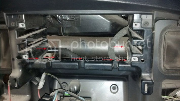

Arrows denote the areas cut. The plastic braces need to be cut down as well, as shown, to allow the stereo to fit in. Used a Dremel with a cutting disc for the front cut, and slowly cut the rest with a hacksaw blade in hand.
There is a spot in each corner up top that needs to be cut as well. They don't quite allow double dins otherwise.

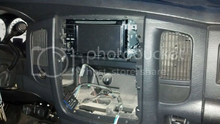

Test fitting the stereo with my custom brackets.

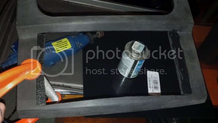

Clamping on a piece of ABS. I cut pieces to fit up to the stereo, then cut pieces for underneath as a brace, and used liberal amounts of cement. They aren't going anywhere. You can see that the other side is on already.

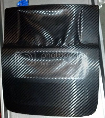

Vinyl laid onto the bezel. Lots of patience helps here. Most prefer a heat gun, but a hair dryer works just fine for this. Very carefully cut the backing paper in the center from left to right, tearing it if need be. Fold it in half, and start from the center, slowly pressing it onto the bezel towards the bottom, then up to the top, peeling the backing away a bit at a time. If you hit any areas that don't line up well, use heat and stretch (very important at the bottom and top). Using this method will provide you with a smooth finish. When you stretch with heat, hold in place until it cools and maintains the shape. Use plenty of heat and patience to fit around the outside edges. Remember to trim up around areas that will reconnect with the dash piece.
Carefully cut out the openings, leaving at least 1/2" overlap. You can trim down from there as needed. You will use a lot of heat and stretching to form around edges here. If you get a couple spots that don't quite want to curve around to the backside, it's ok, because the heater/4wd/stereo will hold them in place and it won't be noticeable. Just keep that in mind when installing it.
The vinyl all done. When doing the stereo section, cut diagonally almost to the corners, leaving just a little bit to stretch with heat around the corner. The rest will fold around to the backside.
